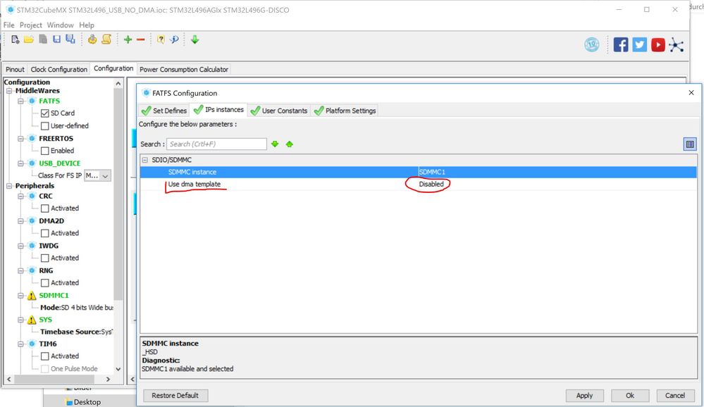

feuerwolf
Senior
Posted on March 05, 2018 at 11:27
I think your problem is DMA related. CubeMx generates wrong SDIO - DMA Code . There are plenty of discussions here.
https://community.st.com/0D50X00009XkXgUSAV
Just read throug the Forum.
In order to use Sd Card without DMA you have to config Cube Mx properly. I found that it integrates DMA even if you did not choose it, thats why your programm fails.
Here I postet the solution
https://community.st.com/0D70X000006Ss9JSAS

Posted on March 06, 2018 at 07:39
The CubeMX project has always had Use DMA Template Enabled.
DMA is not being used.
