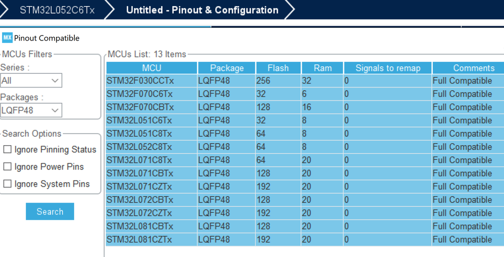

Hello
I designed a card with STM32L052C6T6 mcu, but I can't find this mcu in Turkey.
What would you recommend as a pin to pin instead..
I found stm32f103c8t6 but if anyone else please advise

CubeMX has a method to find matching parts.

The List Pinout Compatible MCUs feature of CubeMX is useful here.
There are a lot more results if you ignore power pins. Presumably it treats VDD and VDD_USB as different.
https://community.st.com/s/article/how-to-find-compatible-devices-for-an-mcu-stm32g473cb-as-example

How to enter there​
Operi.1
thank u so much solved
