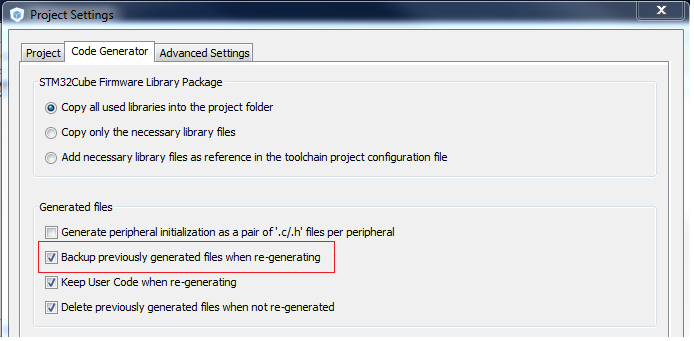

2016-10-14 4:11 AM
Posted on October 14, 2016 at 13:11
-Syrine-
Hi dieter
Go to project>setting >code Generator tab, then select this option: ?Backup previously generated files when re-generation??The .bak extension is added to previously generated .c/.h files. Keep user code when regenerating the C code. This option applies only to user sections within STM32CubeMX generated files. It does not apply to the user files that might have been added manually or generatedvia ftl templates.?
