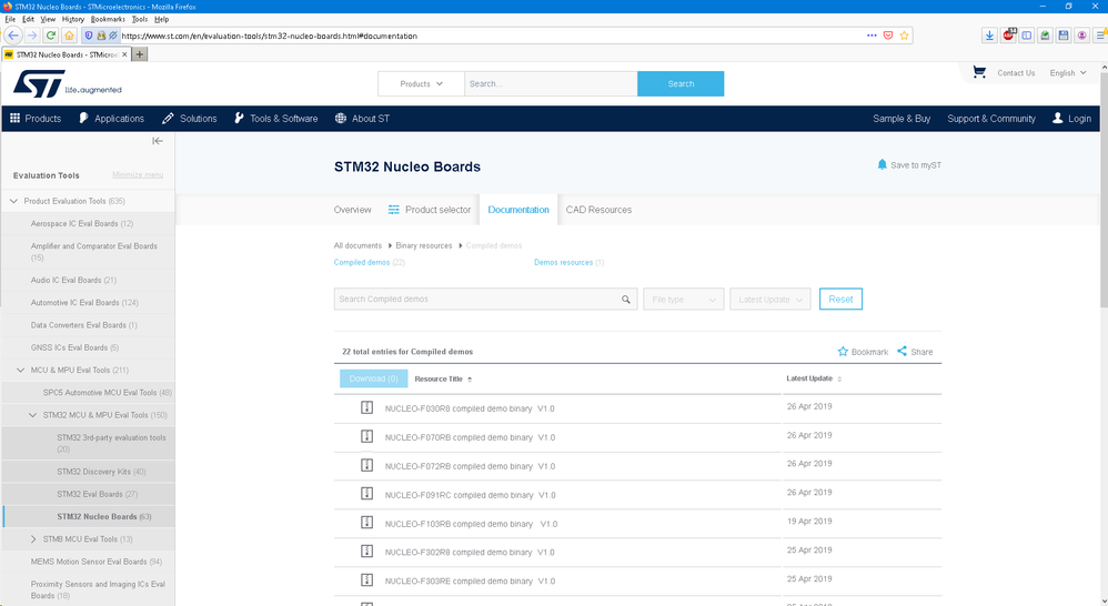

waclawek.jan
(can't give link as ST's web designers indulge in excessive javascripting).
Yes, you are right, it is not there.
The source code is not the same as what is running in the board from the factory.
The factory code starts by flashing LD3, then when B1 is pressed it changes to flashing LD2, and then when B1 is pressed it changes to flashing LD1. When B1 is pressed a third time, it goes back to flashing LD3 and the sequence can be repeated.
