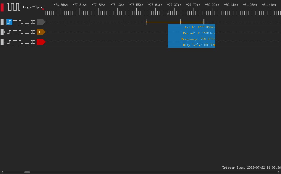

I try to use TIM_DMABurst to generate exact number of pwm pulses.
But I found after call HAL_TIM_DMABurst_WriteStart and HAL_TIM_PWM_Start, it enter HAL_TIM_PeriodElapsedCallback. And then if I call HAL_TIM_PWM_Stop it will stop and generate no pwm. If I call HAL_TIM_DMABurst_WriteStop and HAL_TIM_DMABurst_WriteStart it will continue generate PWM but the wave is wrong

dming.4
The core like this
First start TIM_DMABrust with
  aSRC_Buffer[0] = 7200 - 1;                     /* ARR */
  aSRC_Buffer[1] = 7 - 1;                        /* RCR */
  aSRC_Buffer[2] = (aSRC_Buffer[0] + 1) * 0.2;   /* CCR1 */
and then in the HAL_TIM_PeriodElapsedCallback change aSRC_Buffer
	  if (g_irq_cnt == 1) {
		  aSRC_Buffer[0] = 3600 - 1;                     /* ARR */
	  } else if (g_irq_cnt == 2) {
		  aSRC_Buffer[0] = 1800 - 1;                     /* ARR */
		  aSRC_Buffer[2] = (aSRC_Buffer[0] + 1) * 0.4;   /* CCR1 */
	  } else if (g_irq_cnt == 3) {
	          aSRC_Buffer[0] = 900 - 1;                     /* ARR */
	          aSRC_Buffer[2] = (aSRC_Buffer[0] + 1) * 0.6;   /* CCR1 */

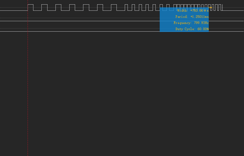

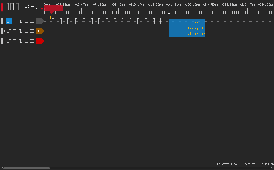

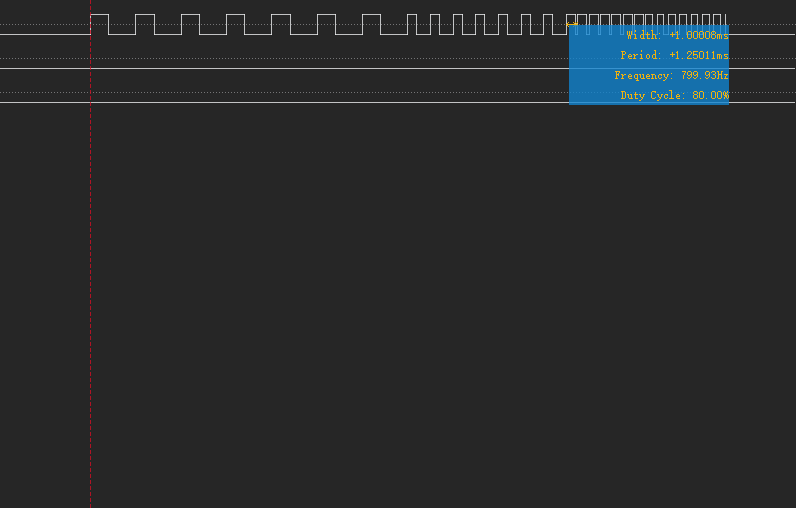

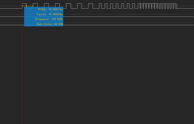

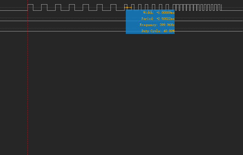

but i get pluss like that
0693W00000QLrR1QAL.png0693W00000QLrS4QAL.png0693W00000QLrSYQA1.png0693W00000QLrSxQAL.png0693W00000QLrT7QAL.pngand in the end it will generate a very small pluse
