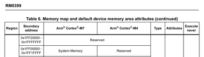

When accessing the System memory area from the Cortex-M4 on the STM32H755, a HardFault occurs.
JE2
I'm using a NUCLEO-H755ZI-Q board.
I tried to read following address.
  • TEMPSENSOR_CAL1_ADDR (0x1FF1E820UL)
  • TEMPSENSOR_CAL2_ADDR (0x1FF1E840UL)
But I can't.
 it causes HardFault interrupt.
I also tried to read the area from Debugger.
Debugger said
Failed to execute MI command:
-data-evaluate-expression *((short*)0x1FF1E820)
Error message from debugger back end:
Cannot access memory at address 0x1ff1e820
But it is possible from Cortex-M7.
I tried other System Memory area, But I can't.
I think Cortex-M4 cannot access System memory area without special sequence.
How do I access the area form Cortex-M4?
Someone, please help me.
The 0x1FF00000 area is Reserved on the M4 core and cannot be accessed on the M4 core. It can only be accessed by the M7 core.
JE2
Oh! I had overlooked it.
Thanks for your quick reply!
