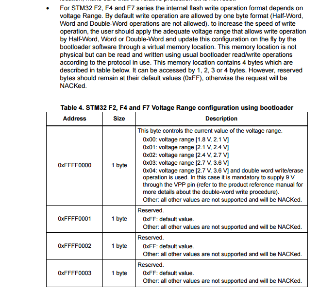

Whats is Device Feature in dfuse ?
Uwe Bonnes
Principal III
Posted on May 01, 2017 at 15:57
E.g the F767 offers 4 dfu interfaces:
..  alt=3, name='@Device Feature/0xFFFF0000/01*004 e', serial='395734643435'
... alt=2, name='@OTP Memory /0x1FF0F000/01*001Ke,01*032 e', serial='395734643435'
... alt=1, name='@Option Bytes /0x1FFF0000/01*032 e', serial='395734643435'
... alt=0, name='@Internal Flash /0x08000000/04*032Kg,01*128Kg,07*256Kg', serial='395734643435
While I understand alternate interface 0-2, I don't find any information about the 'Device feature interface' . An3156 Table 6. mentions it as introduced with V2.1, but gives no further hint.

Imen.D
Posted on May 08, 2017 at 14:08
You may refer to the
http://www.st.com/content/ccc/resource/technical/document/application_note/b9/9b/16/3a/12/1e/40/0c/CD00167594.pdf/files/CD00167594.pdf/jcr:content/translations/en.CD00167594.pdf

Posted on May 08, 2017 at 14:56
Thnaks for the answer.
However the phrase 'device feature set' is no mentioned in section 3.4 'Bootloader Memory management' . I proposed to add the phrase 'device feature set' somehow in that section.
