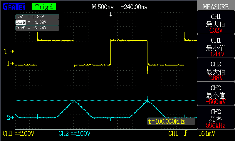

What‘s the actual GBW of OPAMP in STM32F303?
KMak
(yellow line: non inverting input
blue line: output of OPAMP )
I am using the NUCLEO-F303RE board and now I am testing the OPAMP3 , which is one of the peripherals in STM32F303.
I have set the PA1 as non inverting input, PB2 as inverting input. And I input differential signal (up to 400kHz) to OPAMP3. It seems that the voltage OPAMP output is too low.
According to​ official manual, the GBW of OPAMP is 8Mhz. But now this OPAMP has bad performance when input signal is 400kHz.
How do you think about it?
1 REPLY 1
AvaTar
Lead
A 400kHz rectangular signal is not "400kHz" in terms of bandwidth.
