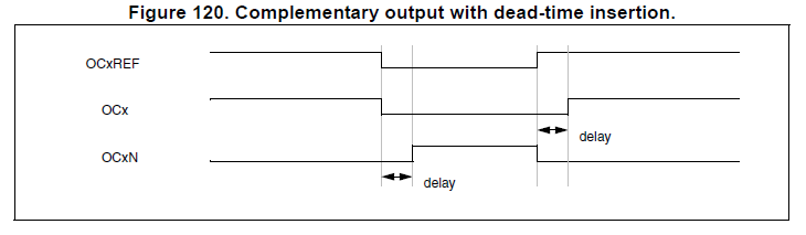

what is difference between TIMx_CH1 and TIMERx_CH1N

Generally one is the reference from the timer, the other the complement, but the edges can be adjusted. There is coverage in the Reference Manual ''Complementary outputs and dead-time insertion'', review that for specifics. The complementary pin can't be used as an input. See also the timer block diagrams.
