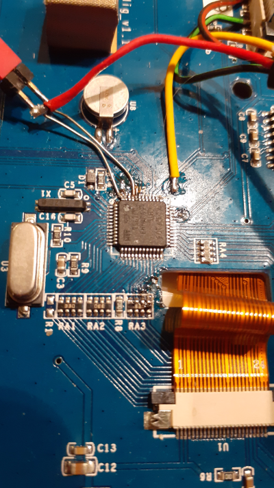

I’m a newbie when it comes to flashing microprocessors. I am wondering if anyone can deduce what I may be doing wrong given the following set of facts.
1. The device I was trying to repair had the symptom of halting after the progress bar instead of booting into its multi-meter software on power-up. This is a well-known fault for this particular meter and there was a set of instructions for saving the calibration from the existing firmware, merging it with a known good firmware and then reflashing.
2. After flashing, I no longer get the progress bar on power up. I get random pixels and nothing more, even though the STM32 ST Link Utility verifies the firmware flashed matches the firmware file. This is also the case if I flash the entire known good file with its included calibration section instead of my saved calibration data. It’s a128K file, the flash starts at 0x08000000.
3. Given that STM32 ST Link Utility says what is flashed matches the source file, what else could I have done wrong that would prevent the firmware from running? nRST_STOP and STDBY and WDG_SW are checked in option bytes. After flashing, I remove the pin holding BOOT0 high. STM32 ST Link Utility sees the processor as STM32F10xx medium density with device ID 0x410. It’s a GigaDevices GDF103xx. I just get the feeling that I am not loading this firmware properly. Very much stumped. Any ideas?

Dear @bobcov ,
Can you share a picture of the top marking on the device.
if flashing is correct , then you can make a run and see the PC - Program counter ? Versus a good device ( multimeter ) running fine .

Hi, hard to get a good picture, but I hope this is good enough. A friend did the soldering. Maybe what I am seeing is a result of something bridged? I will look under a USB magnifier scope today, but if I remember correctly, I checked for the basic fault condition after the connections were attached but before I tried the first flash. I don't think it is something related to the connections, but it is possible. I'll ask about the program counter with the guy who did the soldering. What program do I need for this step? I can use Ubuntu or Windows 10.   Thank you very much for your input.

August 18, 2024
Did you dump the original flash contents before overwriting it? if so, try re-flashing that and see if you're at least back you started. Then report back.
Can you be sure that the manufacturer didn't have multiple revisions in circulation, which may not be entirely firmware-compatible? for example, there might be (I'm just guessing here) some kind of ID mechanism (resistors, ID chip, small EEPROM) on the PCB which the flash checks before booting.

If flashing the original firmware leaves you in the same state, then obviously the (current) issue is not with the modified firmware. A solder bridge, or some damage, seems more likely. Also, keeping your mod wires connected while booting might affect the circuit - it depends on what you connected. Connecting something to the SWD pins shouldn't usually matter, but if you put something on the reset pin or if your ST-LINK clone is pushing power on the voltage rails - that could be an issue.

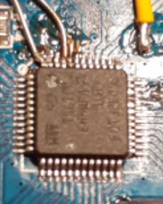

STOne-32
August 19, 2024
Hi @bobcov ,
I encourage you to get an STM32F103CBT6 from STMicroelectronics , the part shown is from GD and is not our STM32F103 :

BarryWhit
Lead
August 19, 2024
 I also encourage you to use original ST parts, but I would strongly discourage you from replacing the part inside a board you are repairing with an original but essentially different part number from ST. They are meant to be compatible of course, but this is never 100%. Software developed and tested on one may exhibit issues if you try to run it on the other. This could be due to silicone differences, or even an explicit check of the vendor ID in the firmware.
Moreover, this particular Gigadevice chip was marketed as STM32F103 compatible but with a significantly higher max clock frequency. If the manufacturer made use of this difference, it would be "not good (TM)" to sub an original STM32F103 for it.

That may have been the case back in the day, but this particular meter was designed and built by Owon and even has the Owon multimeter XDM2041 markings on the boards. And also, just like Owon, this meter has the known fault of corrupting flash, which is what got me on this adventure.

If the dongle was never powered on when the meter was turned on, it should not be the issue. a solder bridge or damaged component is still more likely.
1. measure resistance between voltage rails and GND.
2. check every pair of adjacent pins (near reworked areas) for shorts, with a multimeter.
3. Note everywhere you see flux reside. Clean the flux residue thoroughly then look at all the solder joins with a microscope or cheap 30-40x loupe. The resistors by the flat printed cable look dodgy from the image, for example.
4. check whether any chip pins have lifted from their pad while you were applying heat.
Visual inspection can uncover obvious solder bridges, but they also play hide-and-seek with you. Measuring continuity with a multi-meter is more ***-proof. thorough cleaning is crucial since the flux goop can hide defects.
Before anything else, perform all these steps and thoroughly. Until you do, there's no point in suggesting next steps for general troubleshooting.
