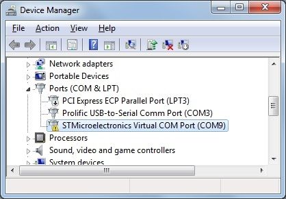

Hey Guys,
After I programed vcp for STM32F427 Eval board by following the example of STM32F429Discover board, but when I plug it into the PC, The PC can find it but always get a warning marker on the Device manager as shown below. Anyone have the idea on this problem?

Posted on January 17, 2014 at 23:31
Like you installed the 32-bit driver on a 64-bit machine, or it expects a signed driver?
kqian
Posted on January 20, 2014 at 13:22
I used the same driver from the STm32F4Discover board demo. It works with the discover but not on my board. I believe some thing wrong on my c code.

Posted on January 20, 2014 at 17:10
The PC just show the driver was not successfully installed, but when I plug the Discover board in, not this error come.

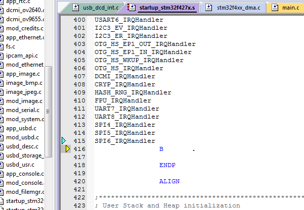

Posted on January 21, 2014 at 23:11
I used the demo code from STM32F429 Discover, do some modification, and add it to my code on the STM32F427 Demo board. I found that when I plug in the USB cable, it is trapped into
SPI6_IRQHandler
