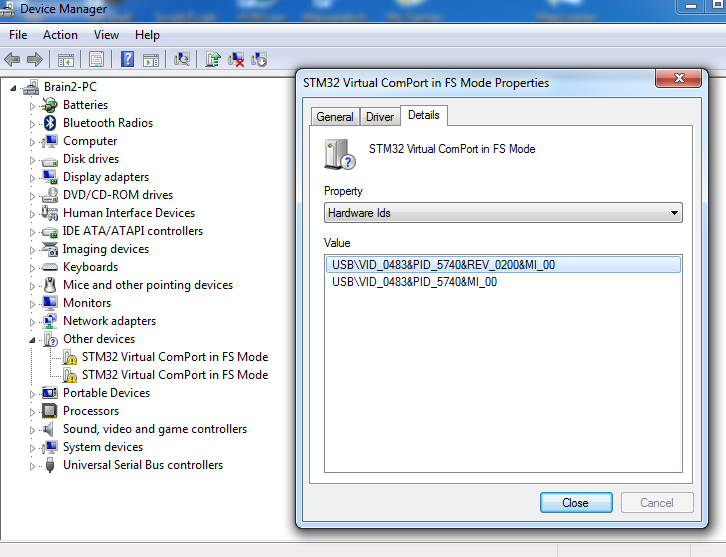

VID and PID are the same, but widows first found a composite device (two Virtual COM ports). Which is strange, because after installing 1.3.1. it become a single device. I'm compiling CDC example from
http://www.element14.com/community/servlet/JiveServlet/downloadBody/51670-102-3-272404/STM32F4DIS-BB%20Software%20Examples%2020130307.zip
peterdonchev
Senior
Posted on February 03, 2015 at 21:54
I tried with another computer, the result is the same.

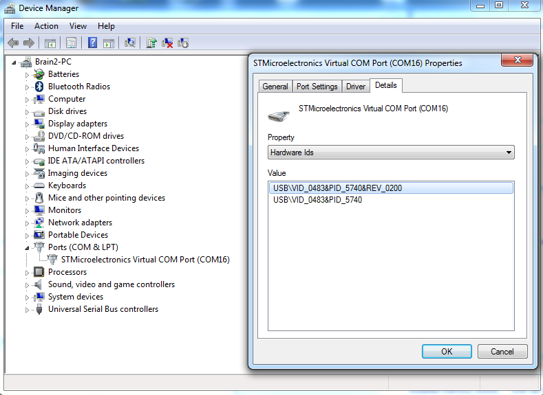

This is what I got, after discovery board was connected (Windows Update did not found a driver).0690X00000605EWQAY.png
And after installing 1.3.1.:

Ah, I remember.
To get ST's CDC driver from Windows Update, The Device triad (class, subclass and protocol) of the CDC device should be (0x02, 0x00, 0x00). Windows treat a CDC device of Device triad (0, 0, 0) as you have seen. The VCP example in STM32_USB-FS-Device_Lib_V4.0.0 has correctly set it up, as follows. And then, this example finely works with Windows Update and VCP_v1.4.0

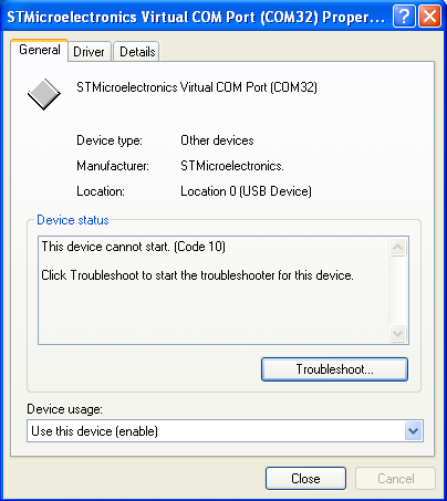

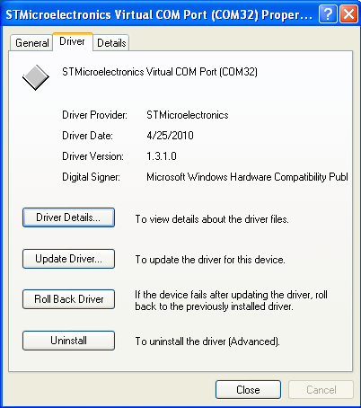

rc
Posted on May 20, 2015 at 18:33
I did the change for device class in usbd_desc.c but in Windows (XP) I get this:
I ran the 1.4 installer but perhaps it does not support XP since the driver that shows up is:
Is there any way to get this to work on XP?
What about on a Mac?
