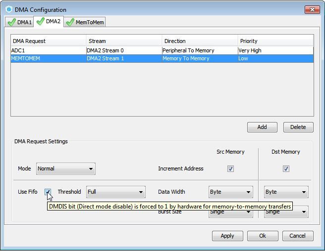

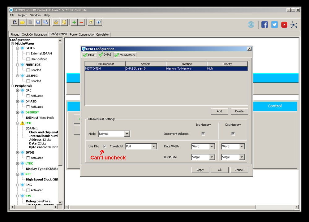

Few days ago accidentally found that DMA FIFO mode checkbox can't be unckecked.
However it should not be a problem to simply change ''DMA_FIFOMODE_ENABLE'' to ''DMA_FIFOMODE_DISABLE'' in code. I think this could be a minor bug.
I'm using latest CubeMX version 4.21.0
Screenshot here:

Posted on August 18, 2017 at 15:06
Hello
Ivanishvili.Giorgi
It is normal that you cannot uncheck the Use Fifo checkbox in this case:
  • the DMA memory buffers are used in either Fifo mode or direct mode
  • but direct mode is not allowed for memory-to-memory transfers
  • and DMA2 is the only controller that can perform memory-to-memory transfers.
There is a pop-up when the cursor is placed on the Use Fifo checkbox that states: ''DMDIS bit (Direct mode disable) is forced to 1 by hardware for memory-to-memory transfers''.
