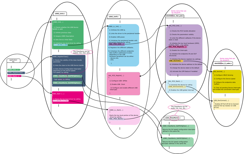

Now, the implementation of ST USB library,
usbd_core and usbh_core files include the implementation of the core state machine process and the enumeration and the control transfers processing.
usbd_ctlreq and usbh_ctlreq files include the implementation of the processing of the control requests required for the device enumeration.
usbh_ioreq and usbd_ioreq files include the implementation of different USB transactions process.
In host mode:
In device mode:
USB stack ensures the correct reception and decoding of the host request and then device state modification accordingly. For further details I suggest you this interesting WIKI

FBL
Hi @krn
When a USB device is connected, it initially draws a limited amount of power (up to 100 mA for USB 2.0).
During the enumeration process, the device sends its descriptors, including the Device Descriptor, which contains the bMaxPower field indicating the maximum power the device requires. The enum process wil lfail in case it cannot provide the requested power.

FBL
Hi @krn
This bit reflects the enumeration is done which means simply executed not necessarily successful. Only the USB stack can interpret the enumeration if it is successful or failing.
Best regards,
FBL
