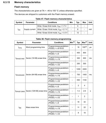

I successfully got USB DFU bootloader running based on this video.
But one question: why is FLASH_PROGRAM_TIME 50 ms?
How is this value dervied? What is the minimum possible value?
Thx.

Flash programming time is silicon hardware dependent on each of our MCUs series and contains two parts : Writing or Programming and then Erase . The granularity of each unit is different. Here is an example for STM32F42x Datasheet  :
So let’s imagine in your case yo will program at a time a Stream buffer of maximum data is 1024 bytes ( just a example ) thru USB DFU , so if you pack these buffer in 256 32-bit word and we program in 32 parrallism mode you need 256 * 100us ( max value ) ~ 25,6ms timeout is required  as minimum and with margin and good software optimization in the loop I would hardcode it as 30 ms . This timeout is required to tell the HOST to wait and the device is busy during that period .
Hope it helps you to understand the logic .
