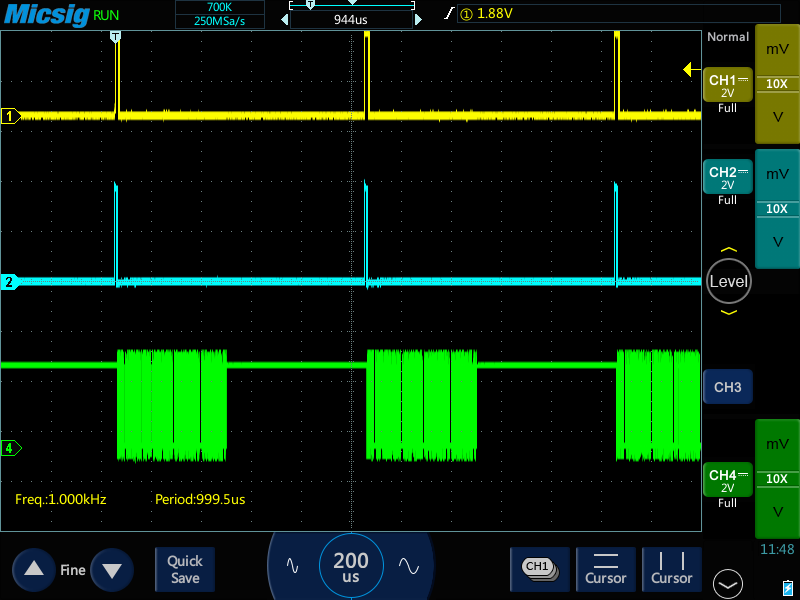

in these interrupt routines i move somo pin so that i can't verify on the scope the activities.
Channel1-yellow and channel 2-blue goes high when the TIM event happens
Channel 1 goes low ath the end of ADC conversions,Channel 2 goes low at the end of ADC DMA transfer
A 3rd scope -green channel is connected to the UART Tx pin
First thing i notice is that the ADC DMA transfer pulse is prior than the ADC EoC,maybe because of the highest priority of the DMA transfer interrupt?
Anyway everything looks okay until here.

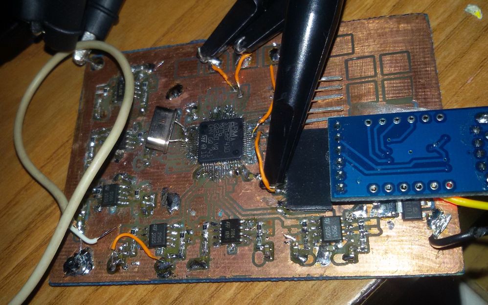

I 'm beginning to think that it is an electrical problem .This because if i speed up the clocks from 48 to 96 MHz the problem is even worse.I want to check grounds and capacitor,justo to exclude it.
Consider that i did the board by myself in a fast proptotype way0690X00000604FAQAY.jpg

SOLVED.It depended by hardware:
As you can see it is not exactly professional:
anyway
1)I put some capacitor closer to VDD pins
2)I added 3 'wired vias' across the 2 ground planes
3)last but probably more important,i have soldered better the 0402 sized VCAP pin capacitor, it was probably disconnected
In over 20 hours i never had hard fault,despite i doubled the core speed at 96MHz.
