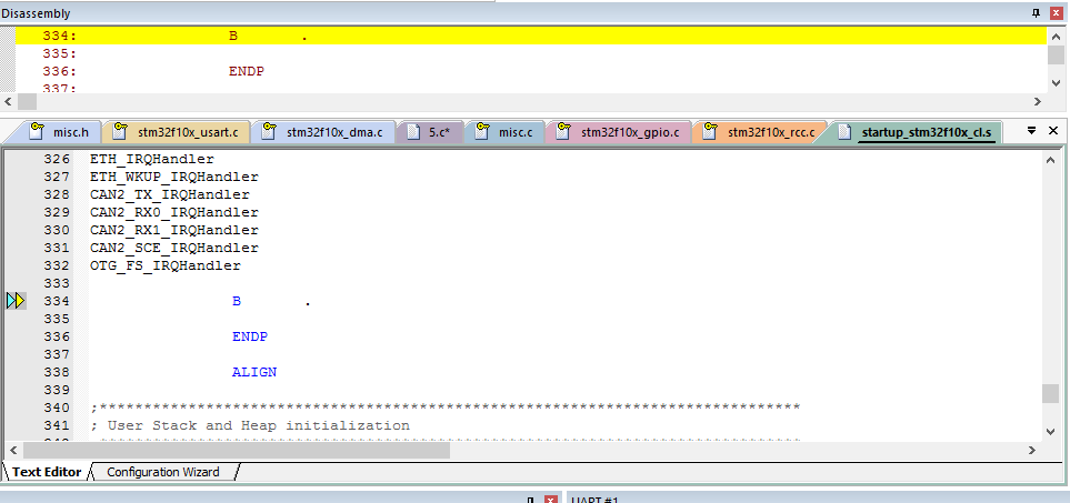

I configure USART1 and enable DMA interrupts but it doesn't do any reaction to receiving data. what is my mistake?

You are only configuring the USAR1 Tx DMA channel (DMA1_Channel4). You should configure the RX channel for receiving data (DMA1_Channel5).

I correct my DMA channel to right states.After I send 10(size of buffer) chars it hangs in above line and do nothing.
before sending the 10 chars it shows ''Hello the(0) world'' correctly
waclawek.jan
Posted on September 09, 2016 at 09:28
DMA1_Channel5_IRQHandler()
 i.e. remove ''n''

Thank you waclawek.jan
It works fine.
