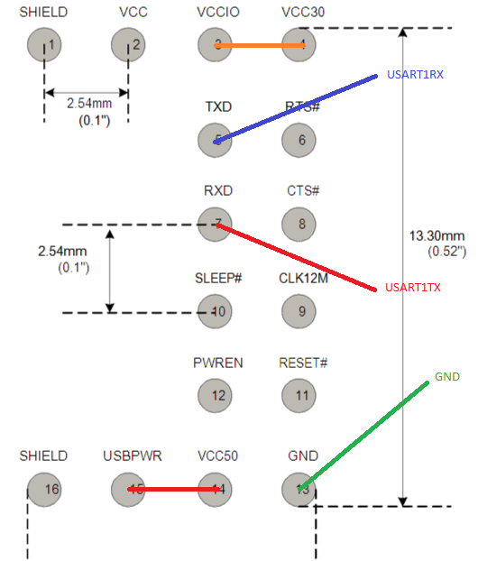

hi moreira.luis.001
i uses MM232R with stm32f4 discovery in a project ..there are 16 pins in MM232R .. Could you please send me the wiring of these different pins ...Thank you.2013-04-12 9:32 AM
2013-04-12 12:51 PM
thank you...
Without connecting Vcc(pin 2)???We’re moving the ST Community to a new platform to give you a better and more reliable community experience.
