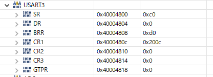

The following are the values of the registers that I checked on TrueStudio. They seem to be set correctly.
However, I am concerned that the value I want to send does not seem to be written in the DR register.
Could you please confirm ?

Might also be advisable not to look at the registers in the debugger, as reading the DR is invasive, clearing bits in the SR.
Close the peripheral view once you've concluded that the CRx/BRR are set appropriately, and the APB appears to be clocking it properly.
