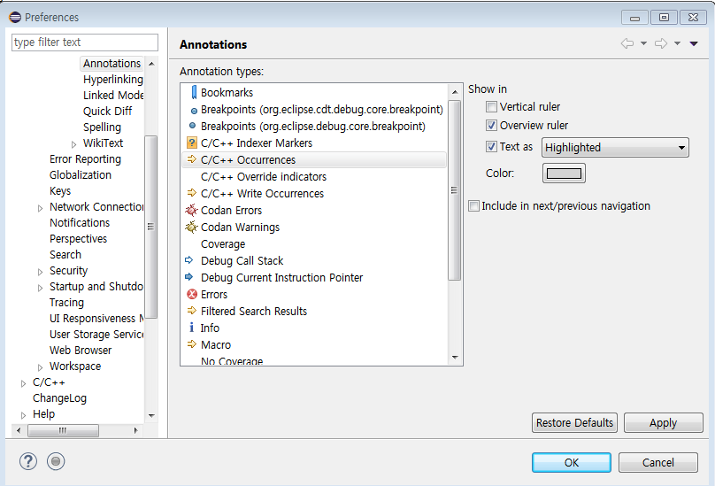

I think you might familiar with  this issue if you are proficient user of Eclipse +STM32.
In my #include section of main.c file.
Red error line indicates like
At the same time the system says to do indexer marker,
Kindly suggest me what to do for this issue?
