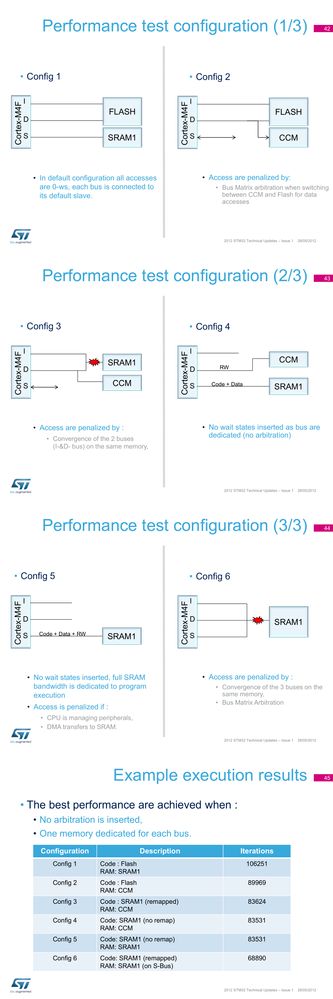

when running code in RAM, the manuals tells
'To get the max performance on SRAM execution, physical remap
should be selected (boot or software selection).'That way code from RAM can be fetch I-Code interface.
Does this imply that Code in Ram should to be linked to address 0 and placed at 0x20000000?

Yes, but it does not imply automatically maximum performance:
