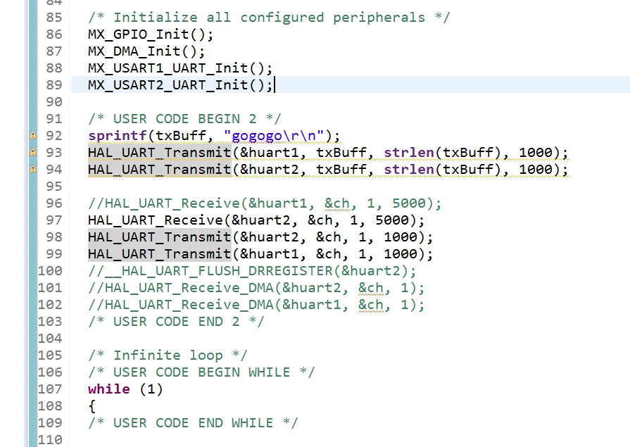

Hi all
I'd like to use UART2 to receive data, but It seemed to be failed, only could transmitted data.
I used the same codes in UART1, everything is fine,
So I think HW and SW parts are fine except UART2.
I had not connect SB62 & SB63  to enable PA3 & PA2, and used the CN3 of the st-link part for my project.
May I miss something? Or I should connect
SB62 & SB63 to use PA3 & PA2 pins?
If anyone could tell me how to fix it?
Thank you in advance.

Some nucleo boards connect USART2 to the STLINK JTAG programmer on the board.  It's used as a serial port through the STLINK USB.  Check your schematic; to use it you may need to remove some jumpers.  For USB it's fixed at 9600, 8 bit, no parity, 1 stop, and should appear as a COM port on a host PC.

Maybe some information available in UM1724 (see
http://www.st.com/resource/en/user_manual/dm00105823.pdf
Please refer to chapter 6.9, especially this area :
SB62/SB63 OFF removes connection between PA2/PA3 and D0/D1 on CN9 (or CN10).
Could you confirm your setup is as follows ?
- SB62-SB63 OFF, SB13-SB14 ON so that PA2/PA3 of L476 are connected to STLINK,
- PC connected to USART2 using Virtual com port, through ST Link
If so, i would also expect it to work.
