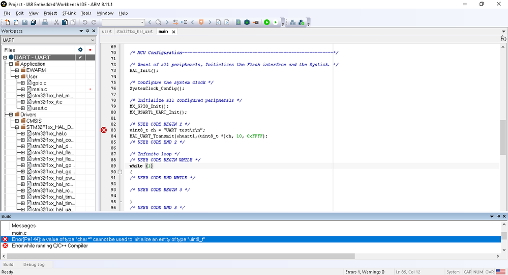

I want to operate code like below.
ch = ''UART test\r\n'';
HAL_UART_Transmit(&huart1,(uint8_t *)&ch, 10, 0xFFFF);***************************
But appear error when compile.
Please let me know your comment.

Hi L C,
About the issue with the transmision and the use of the CubeMX you could check this post:
https://community.st.com/0D70X000006SciuSAC

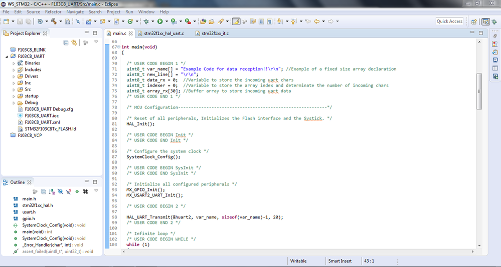

For uart tx I prefer to use the char array declaration:
uint8_t var_name[] = ''insert you text here'';
That's useful when you have a fixed size text to transmit, because you can use the function sizeof() to determinate the size of your array and in the other hand the array variable is a pointer so you don't have to make any cast in the function, so in the uart transmit function could be:
HAL_UART_Transmit(&huart2, var_name, sizeof(var_name)-1, 20);
the
sizeof(var_name)-1 is because when you create and array on this way its size is the number of chars plus one for a null value in at the end of this, so if you don't want to transmit the null char you have to put there the -1. Otheradvantage to use this form is that if you change the text in your array you don't have to modify the uart transmit function.

Attached to this post is a code made for and Blue Pill board that have a F103 micro for the IDE SW4STM32, in the same folder is the .ioc file is you want to check the CubeMX configuration.

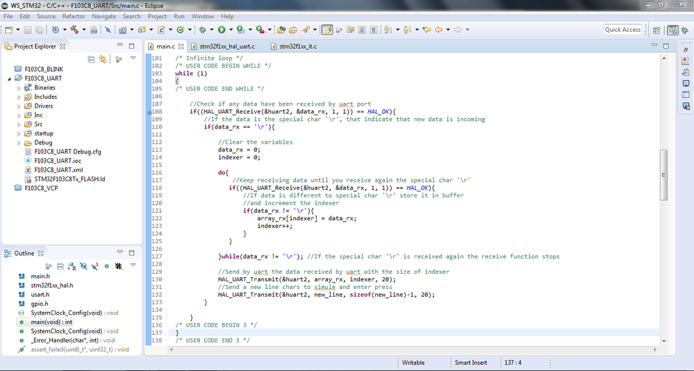

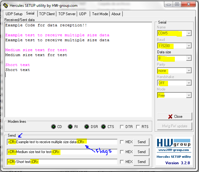

I'm using the char '\r' as flag to receive frames until 30 chars, you could check the main.c file, I think that the same code will work on your board, here is screenshots of the code:
And I test it with Hercules, just include the flags in first and the last place of your frame and its done, I'm using a USB-to-serial converter wired to the board, and the uart is configurated to 115200, parity none, 8bit:
Hope it helps to you!
