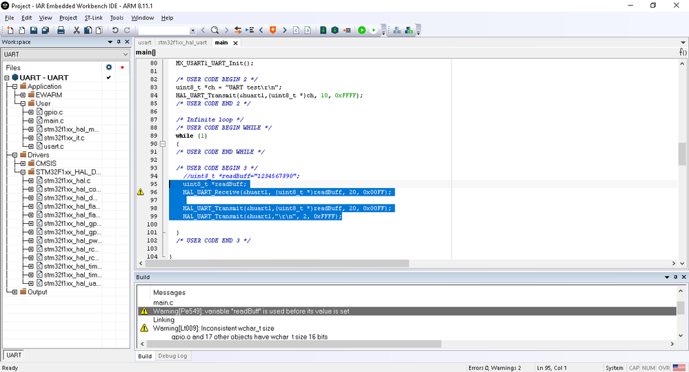

Posted on July 25, 2017 at 02:42
Dear ALL
The screen dump with error message and source code are attached.
Please take a look and let me know your comment.
BR
Posted on July 25, 2017 at 02:46
It is pointer to multiple chars, you can't define it as 'char ch' needs to be 'char *ch'
char *ch
= 'UART test\r\n'; // It is a pointer
HAL_UART_Transmit(&huart1,(uint8_t *)ch, 10, 0xFFFF); // It is a pointer, you don't need the address of the pointer, lose the &

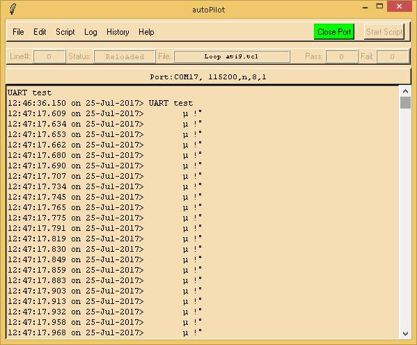

Posted on July 25, 2017 at 03:59
Clive One
Thanks for your help. It is work fine.

Posted on July 25, 2017 at 04:50
Use strlen(), make a subroutine that takes a string input, and calls HAL_UART_Transmit() with the appropriate parameters.
On the receive side fill a buffer as you receive characters and parse them, for instance wait until you get the carriage return character and then feed the accumulated string to routines that process that.
Posted on July 25, 2017 at 06:54
Clive One
I have try below code, but not success.
Do you have similar example for me?
BR
________________
Attachments :
main.c.zip : https://st--c.eu10.content.force.com/sfc/dist/version/download/?oid=00Db0000000YtG6&ids=0680X000006HyMc&d=%2Fa%2F0X0000000b9W%2Fs4Pl0JZYRg1C.ysA.qtWFm51jGGUy9pZF7kB1_sCbQo&asPdf=false
Posted on July 26, 2017 at 13:45
uint8_t readBuff[20]; // Must define a buffer with space in it to hold the data
HAL_UART_Receive(&huart1, (uint8_t *)readBuff, 20, 0x00FF);
If planing on using str functions consider allocating 21 characters so you can place a NUL at the end.
You need to work on your C coding skills.
Sorry I don't have HAL examples, please review subdirectories under the Cube install.
