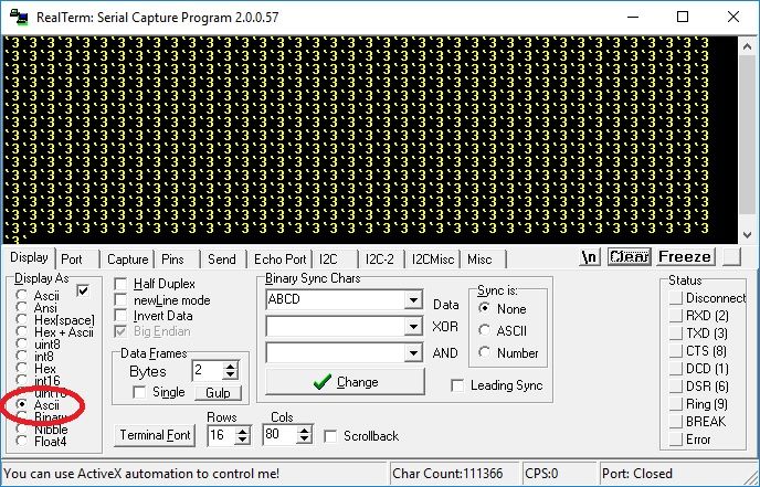

I have an STM32F1 and am running the UART printf example from the standard peripheral library. I've modified the code to allow me to use USART3 (I'm using a custom pcba and only USART3 is wired to a connector mounted on the board). I've connected USART3 to a serial terminal on my computer (RealTerm) using an FTDI USB-UART converter. I am successfully receiving data from the UART but the data is incorrect and the terminal complains of a framing error. I am transmitting a single character 'T' but am receiving unknown data:
I am convinced that there is a problem in my code, most likely in how I have configured USART3, but am not sure where. I have checked that my baud rate etc is good in both the code, cable and terminal.
Can anyone help me with this? What is the most likely reason I am not receiving the correct data?

Posted on May 22, 2017 at 14:18
USART3 is not on APB2

Posted on May 19, 2017 at 20:13
Baud rate wrong (bad assumption about clock sources and speeds)
Wrong levels. Device outputs CMOS level, not RS232 level, which are higher and inverted.
Use 2-stop bits, creates a larger inter-symbol gap, if synchronization is an issue.
Try outputting a stream of 'U' characters and measuring bit timing on a scope.
Make sure to test for TXE before outputting to data register.
Posted on May 22, 2017 at 14:12
Hi Clive,
As I said, I'm convinced that the problem in my code. Can you see anything wrong here:
Posted on May 22, 2017 at 15:29
Yep that was the problem, should have been on APB1.
Thank you!
