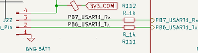

Hi ST community,
I create a simple application using USART1 baudrate 9600 TX pin - PB6 & Rx pin - PB7. I send uart frame each 1 second. J22 connects to CP210x. I see that the RX led of CP210x toggle each 1 second but when I open terminal screen on the laptop with same baudrate, nothing is shown. HAL_transmit return HAL_OK. Tx pin and Rx GPIO pin is configured as default, no pull up and pull down. What is problem here?

Hi all, I have resolved the problem, 1k impedance resister is too large. It cause unexpected noise on Uart bus. I removed it and it worked, so I will close this thread.

If you do not include more details, there are tons of errors that could be in your code.
Attach whole project and we can try to help you.
Error in clocks, setup of otput mux are most common errors that block USARTs; oscilloscope is required to assert that usart is not sending anything ...
Hi @mbarg.1 I attach my project below, please help me check it, I also check logic analyzer but the data on bus is weird
FBL
Hello @BLS_Karo
Do you reproduce on a reference board? like U575 eval or nucleo? Check mapping in USART1 MSP init.
Best regards,
FBL
@FBL No. I implement on my custom board, the purpose is talking to BLE module. I also check msp init, the gpio mapping is correct
BLS_Karo
