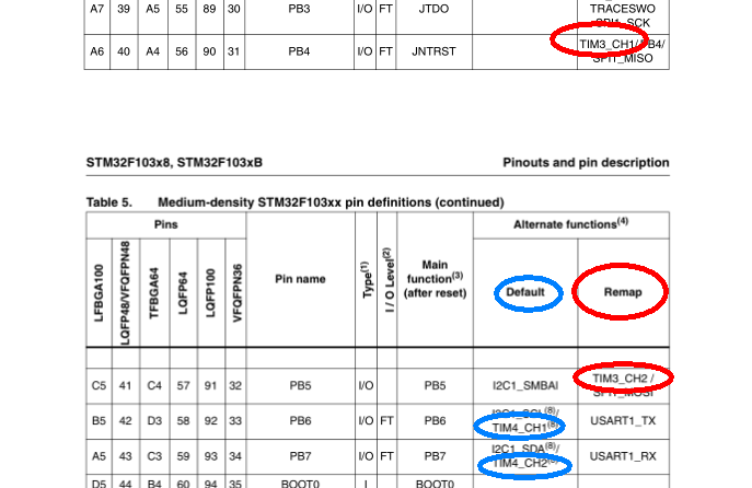

I'm working on a project where I need to set up two encoders.
I use included timers as timer encoder.
encoder 1 is configured on GPIO PB7/PB6
encoder 2 is configured on GPIO PB5/PB4
In order to isolate the mistake (hardware/software), here is what I tried:
  1. First, only 1 encoder wired to the board, only 1 timer configured on my board/code, on GPIO PB7/PB6:
    1. encoder 1 on PB7/PB6: working fine
    2. encoder 2 on PB7/PB6: working fine
    3. So hardware seems to be bine
  2. Then I modify my test code, I kept same code excepted I changed PB7/PB6 for PB5/PB4
    1. encoder 1 on PB5/PB4: not working
    2. encoder 2 on PB5/PB4: not working
What is really strange and I don't understand:
In case scenario 2, if I put encoder 1 on PB7/PB6 and encoder 2 on PB5/PB4, only PB5/PB4 are initialized in my sketch, encoder 2 is not working but encoder 1 on PB7/PB6 is working.
I'm using STD Periph lib, STM32F103 and Keil

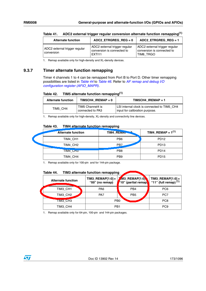

Posted on August 03, 2017 at 13:41
Make sure to enable the AFIO clock to allow for the Remap. The F1 design is a decade old, it had peripheral level remapping (block/group of pins), newer designs have pin level remapping.

Posted on August 03, 2017 at 14:18
According to what I found,
I should manage to do what I want with adding:
RCC_APB2Periph_GPIOC | RCC_APB2Periph_AFIO, ENABLE
and
GPIO_PinRemapConfig
(GPIO_PartialRemap_TIM3, ENABLE);
As i want TIM3 to be on PB4 and PB5
I will test tonight
