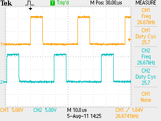

I'm using the STM32F103RCT6.  I need two PWM outputs, where the period and polarity of each is the same, but one output is 180� out of phase from the other.
A duty cycle change must affect both concurrently.  The complementary output configuration is close, but not quite.
I need to be able to do this:
Any ideas?

Errrm, isn't that really a wish for two in-phase PWM outputs, one with the opposite polarity.  The duty cycle of the second is the complement of the primary duty cycle.
There are several ways to synchronize the phases.  The most sophisticated (overkill for this simple task) is using the ''commutator'' ability -- PWM values can be sequentially pre-loaded into registers, and then activated simultaneously.  But with only two signals you have many simpler choices.

If they were in phase with opposite polarity, when one output was 1, the other output would always be 0 (i.e. complementary outputs), dead-time aside.  I'm looking for a Push-Pull configuration.  See this post:

You complement the duty cycle (100% - D%) and invert the polarity.
When the first output is 1%, the second output is 99%.  But inverted, so it looks like 1% but 180 degrees out of phase.

To be clear, you need to use the phase-correct AKA center-aligned PWM mode (up/down counting).
You may want to enable the preload registers to get a synchronized change in duty cycle, although most applications won't care if there is a slight phase glitch with a change in duty cycle.

That did the trick.  Thanks for your help!
