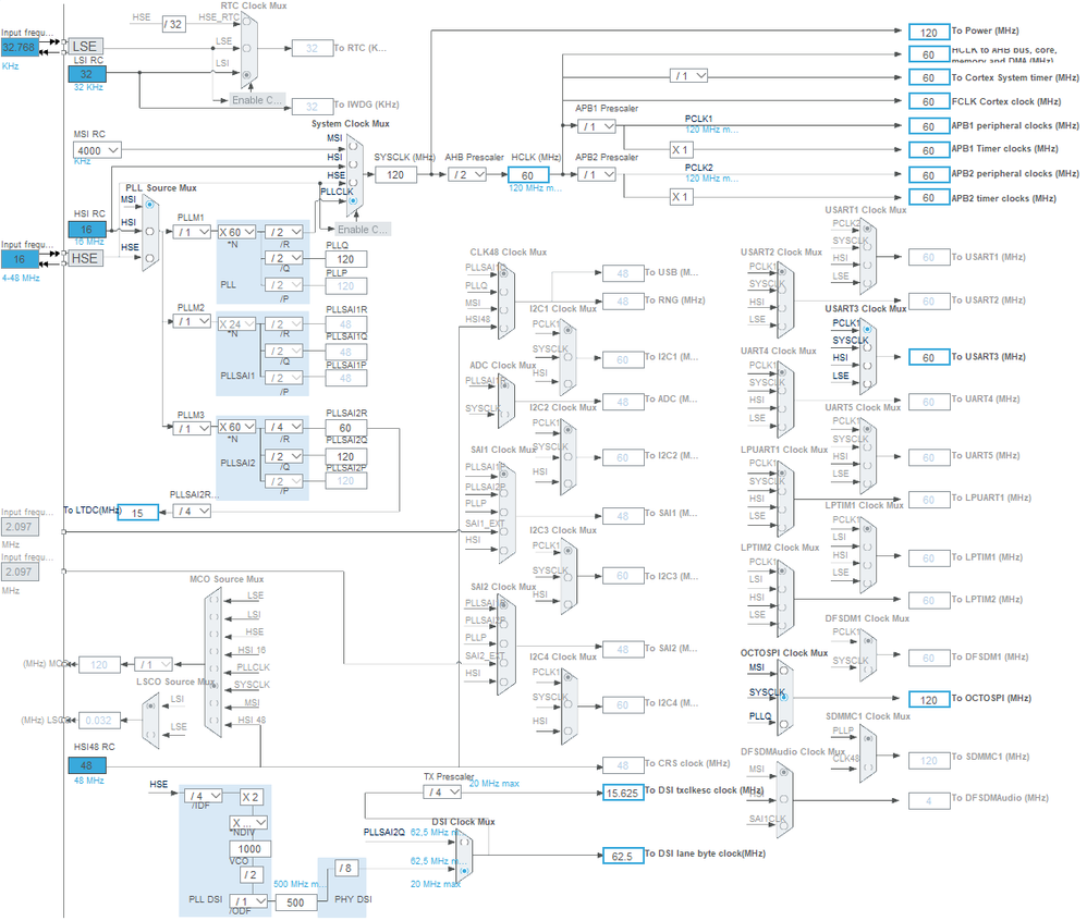

I succeeded to solve my issue, it was coming from a wrong configuration of the FMC timing :
Before :
  Timing.AddressSetupTime = 15;
  Timing.AddressHoldTime = 15;
  Timing.DataSetupTime = 255;
  Timing.DataHoldTime = 0;
  Timing.BusTurnAroundDuration = 15;
  Timing.CLKDivision = 16;
  Timing.DataLatency = 17;
  Timing.AccessMode = FMC_ACCESS_MODE_A;
After :
  Timing.AddressSetupTime       = 2;
  Timing.AddressHoldTime        = 1;
  Timing.DataSetupTime          = 1;
  Timing.DataHoldTime           = 1;
  Timing.BusTurnAroundDuration  = 0;
  Timing.CLKDivision            = 2;
  Timing.DataLatency            = 2;

MM..1
Chief III
Your info is unusable for support. Use external SRAM require perfect clock config and init memory.
You dont show how you create NOK change...
Tooky
Thank you for your answer MM!
Below this is my clock configuration (using the IDE generator)
Let me know if you need me to display the related code generated.
The init code for the FMC (For SRAM interface) :
