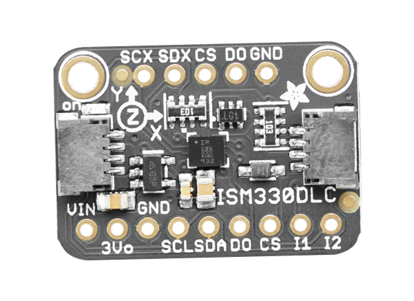

Hi Team,
can i know top marking information of the part number ISM330DHCXTR. i couldn't identify topmarking in datasheet. kindly confirm the same.

It may be possible to use a caliper to help identify pin 1, the IC is rectangular not square.
Figure 24. LGA-14L 2.5 x 3.0 x 0.86 mm package outline and mechanical data (tolerance +/- 0.1mm)
Image source: https://www.mouser.com/new/adafruit/adafruit-ism330dhcx-breakout-board/
https://www.google.com/search?q=ISM330DHCXTR&tbm=isch
Note, order code: ISM330DHCX (Tray Packing), ISM330DHCXTR (Tape & Reel Packing).
:warning:Attention ISM330DLC (Extended operating temperature range: -40 °C to +85 °C) may be different from ISM330DHC (Extended temperature range from -40 to +105 °C) for some reason, merely illustrative image.

Hi Team,
Thanks for response.
Top marking Mentioned : IR-represents standard marking code. 932-represents last 3 digit datecode.
