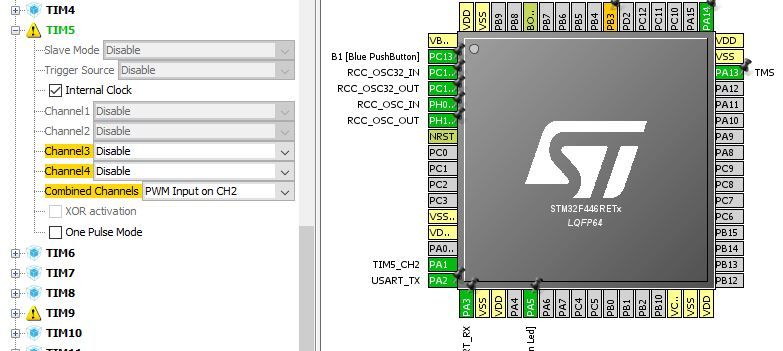

Posted on July 22, 2017 at 18:27
I'm having a little trouble with the algebra -
I'm using an Nucleo F446RE where HCLK is configured to 180MHz and APB1 Timer clock is at 90MHz
With TIM5 free running with prescaler of 1 and arr of 0xFFFFFFFF
I'm having trouble with the formula to reconcile time between increments of the CNT register and its relationship to milliseconds

Posted on July 22, 2017 at 20:33
This procedure can also be done by hardware by select to work with PWM input mode at an appropriate timer
