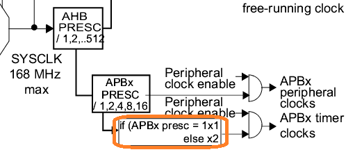

Hi everyone.
I need some explain why this code generating not 1KHz TIM2 interrupt.
I have no idea why generating 2KHz in APB1 clock(30MHz) & PPRE1(0b101) & CKD(0b00).

//Prescaler //APB1clk/Presclr/fOUT = ARR <=0xFFFF   //PPRE1 101: AHB/4=30MHz

Posted on October 13, 2014 at 18:44
Also it's TIMx->SR = ~X, and not TIMx->SR &= ~X

Posted on October 13, 2014 at 19:52
Thanks clive1!
