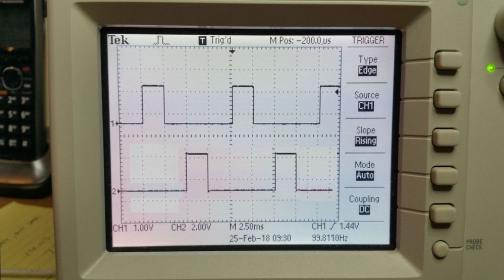

Here's my code to initialize timers 2 and 3. Keep in mind that right now, this code executes with no problem and there is a 100Hz output on PA5 (TIM2) and PA6 (TIM3)
My objective is to offset TIM3 by 180 degrees from TIM2. I am able to do this in SPL, but have had no success with LL after trying different things, including direct register writes to TIM2 and TIM3. The interrupt handlers are functioning OK for both timers.
What do I need to do to the code below to achieve this?

Still getting a result that is not working. I just do not see how to configure the LL system on how to accomplish this.
Both timers will be the same period. Let's say that period is 10ms and the DC is 25%. Then, I need the second timer's output pulse to occur exactly 1/2 the period time. See the attached (hacked) image. Again, this I can presently do in CMSIS, but not in LL.
If TIMx starts at t = 0, TIMy output will be at t + 5ms. Again - I have the code configured so that right now, a PWM is occurring on TIM2 (PA5), TIM3( PA6) and these 2 signals are in phase. The question is, with a TIM2 period = 10ms, how do I get timer 3 to trigger at TIM2 + 5ms ?
Seems it should be easy....but after looking at the LL mechanisms, not obvious.

In the LL code in opening post, this part from your original code is missing:
//set timer 3 immediately to timerPeriod offset/2 = 180 degrees shift
TIM4->CNT = TIM3->CNT + ((uint16_t) (TIM_TimeBaseStructure.TIM_Period / 2 ));
That's the key one though - this is where you establish the phase shift.
I don't Cube, so don't know the exact incantation to do this 'properly' in LL, but the direct write to to CNT just as in the original code will do just fine.
John presented you a more complex but more flexible option using the internal master-slave linking
https://community.st.com/0D50X00009XkhLYSAZ
, but yours will do if you are OK too, if you don't intend to change the phase shift on the run.
Ah, and you want also to move this
/* Force update generation */
LL_TIM_GenerateEvent_UPDATE(TIM2);
LL_TIM_GenerateEvent_UPDATE(TIM3);
to *before* you enable the timers.
Posted on February 25, 2018 at 16:15
jan,
I had the timer offset in my code, just did not post it above. It looked like this:
TIM3->CNT = TIM2->CNT + ((uint16_t) (LL_TIM_GetAutoReload(TIM2) / 2 ));
The issue all along was the placement of the code 'LL_TIM_GenerateEvent_UPDATE'
Once I moved that as you suggested, it worked.Great!
