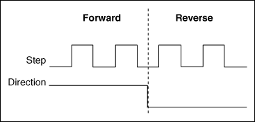

I am trying to configure the TIM2 to act as an up/down counter as describe in Encoder mode 1 or 2. I have the circuit set up to connect PB8 to a count signal and PB9 as a direction signal. I have am having an issue where randomly after an NVIC_Reset the count direction is different dispite the value on PB9 being the same. The itnitialization code is below:

The STM32 timers don't have a 'direction-count' interface/mode, so I wonder how your input signals look like, exactly.
Any 'scope or LA waveforms to show us?

Sorry for the delay in response. The waveforms look like you would expect:
The code above works consistently but at some point the counter starts countingin a random direction at boot.
