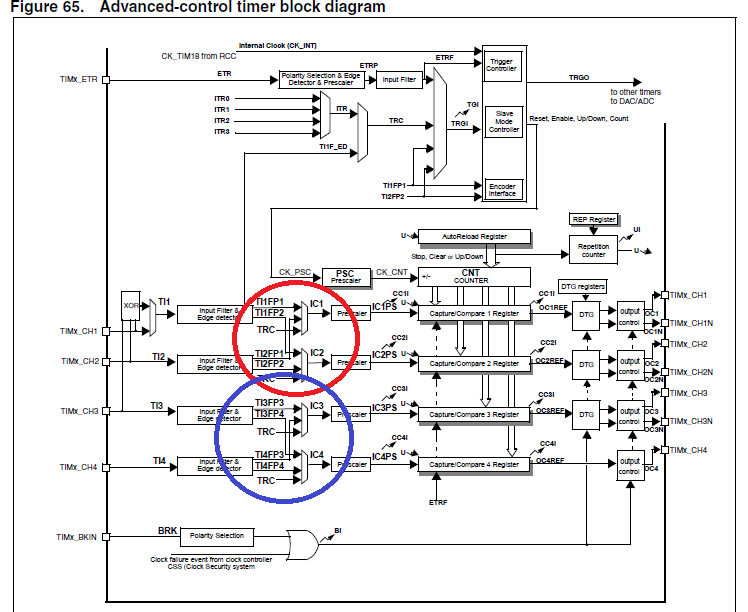

0owarrioro0
Posted on April 19, 2012 at 19:43
like this: I don't know why selecting opposite polarity !
/* Select the Opposite Input Polarity */
  if (TIM_ICInitStruct->TIM_ICPolarity == TIM_ICPolarity_Rising)
    icoppositepolarity = TIM_ICPolarity_Falling;
  else
    icoppositepolarity = TIM_ICPolarity_Rising;
wait for help .
thanks in advance!

The channel pairing is 1&2, and 3&4 and feed the input capture signals (IC1, IC2, IC3, IC4) to the ''Compare'' latches. The PSC and CNT are your time base (sample frequency), you want this ticking as fast as possible, you are latching this count into your registers. CCR2 is going to get ticks you can use to determine the period (ie from rising edge A to rising edge B). I haven't thought too much about the duty, but I'd guess it's looking at the opposite phase of the clock, so you can probably look at the falling edge (CH1) with respect to the next rising edge (CH2).
The timers are complex, I don't claim to fully understand them, the wiring diagrams are the best documentation to start with, but you will need to experiment, and work with the examples.

thanks for your replay .
With your help and I have a detail understand .
But what's the joint gate ''XOR'' which combine the CH1/CH2/CH3 used for in the figure 65 .
