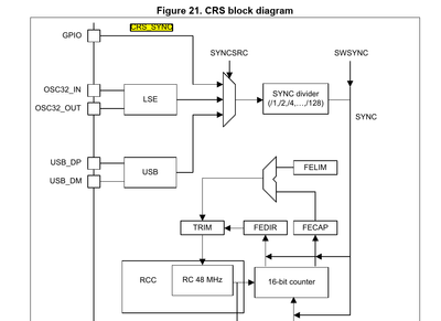

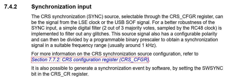

Thanks, we are updating the code as per your suggestions and about to try. One other information is that USBCRS_SYNC (PA10 AF10 function) Is routed in the board to connector. But the USB cable do not have any pins for this? And datasheet doesnt explain what USBCRS_SYNC pin do? can anyone explain about this pin

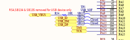

Just from circuit nucleo-L4xx :
PA10 -> USB_ID , but not needed for device only.

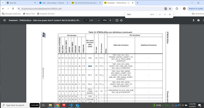

Iam confused, as per data sheet PA10 is  USB_CRS_SYNC,

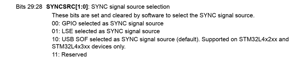

crs_sync seem needed for crystal less -> sync the HSI48
IF you select it as sync source :
from rm:
No, nothing about "Samsung" here. :)
IF you select it as sync source (see my last post) you need it as sync input . (If you use crystal less.)

IF using crystal less , use ->
Was using HSI crystal less , as you suggested changed to  HSE ---> usb-clk ...
No impact, works in mac/windows but not in android. With this change,  may be I saw unknown usb detect error from windows few times.
Also tried changing USB_CRS_SYNC to RESET_STATE in ioc. In our board even though this signal is routed to USB connected, usb cable doesnt take this anywhere.  So still fighting the not able to talk to android issue.

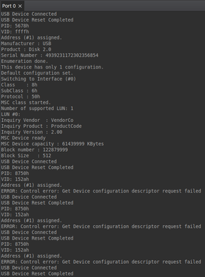

Might be some help, to see the debug messages from USB lib : do you have SWO usable ?
If debug enabled in HAL/usb lib, as host i get from swo :
jaindevasy
Mass storage class showing same issue, detecting on Windows, but not detecting on Android.

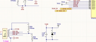

Below showing the schematic in which USB_DM and USB_SYNC is interchanged. Is there any possibility to work the USB in windows, if this pins are interchanged?
No - hey, but everything is possible in certain reality. :)
If really mixed up - correct it. And try connection then...
