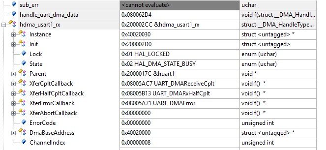

Ihave a similar problem withUART DMA transfer complete/half transfer callback function using CubeMx and HAL.I use UART with DMA on UART RX. I have enabled DMA transfer complete and half transfer interrupts in usart.c:

__HAL_LINKDMA(uartHandle,hdmarx,hdma_usart1_rx);�?�?�?�?�?�?�?�?�?�?�?�?�?�?�?�?
HAL_DMA_RegisterCallback(&hdma_usart1_rx, HAL_DMA_XFER_HALFCPLT_CB_ID, handle_uart_dma_data);
HAL_DMA_RegisterCallback(&hdma_usart1_rx, HAL_DMA_XFER_CPLT_CB_ID, handle_uart_dma_data);

HAL_DMA_RegisterCallback executeswith HAL_OK status, while debugger shows different pointer, to UART __weak functions.Why are called this functions instead of my registered callback?

‎2017-08-17 2:32 AM
in static void UART_DMAReceiveCplt(DMA_HandleTypeDef *hdma)
If your dma is not in circular mode,
The library clear Error flags and disable UART DMA Receiver, also set the handle's RxState to HAL_UART_STATE_READY. and clear its RxXferCount.
{ UART_HandleTypeDef* huart = ( UART_HandleTypeDef* )((DMA_HandleTypeDef* )hdma)->Parent; /* DMA Normal mode*/ if((hdma->Instance->CR & DMA_SxCR_CIRC) == 0U) { huart->RxXferCount = 0U; /* Disable RXNE, PE and ERR (Frame error, noise error, overrun error) interrupts */ CLEAR_BIT(huart->Instance->CR1, USART_CR1_PEIE); CLEAR_BIT(huart->Instance->CR3, USART_CR3_EIE); /* Disable the DMA transfer for the receiver request by setting the DMAR bit in the UART CR3 register */ CLEAR_BIT(huart->Instance->CR3, USART_CR3_DMAR); /* At end of Rx process, restore huart->RxState to Ready */ huart->RxState = HAL_UART_STATE_READY; } HAL_UART_RxCpltCallback(huart);}What's the problem using void HAL_UART_RxCpltCallback(UART_HandleTypeDef *huart)??
‎2017-08-17 4:06 AM
If you did call HAL_UART_Receive_DMA(...), then the HAL library do the following
/* Set the UART DMA transfer complete callback */
huart->hdmarx->XferCpltCallback = UART_DMAReceiveCplt;
/* Set the UART DMA Half transfer complete callback */
huart->hdmarx->XferHalfCpltCallback = UART_DMARxHalfCplt;
/* Set the DMA error callback */
huart->hdmarx->XferErrorCallback = UART_DMAError;
/* Set the DMA abort callback */
huart->hdmarx->XferAbortCallback = NULL;
‎2017-08-17 4:18 AM
yes, I figured it out, but I don't see the point - are there any good reasons that HAL library re-sets this callback to this predefined callback?
