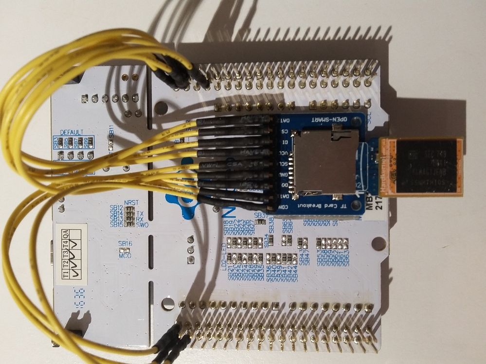

Hi, pretty sure this is a newbie type question. I'm using the SDMMC interface on an STM32L476. Right now it is just wired to a Nucleo board so I can do some benchmarking before committing it to a layout. I'm using STM32CubeMX and following the example in section 3.3 of UM1721 (Fatfs on CubeMX). After learning the hard way pullup resistors *are* necessary (some other posts said not), I am able to talk to a card, but only if I use polled mode ("Use DMA Template" set to disable in STM32CubeMX Fatfs settings). When enabled, the code hangs in the sd_diskio_dma.c SD_Read() routine right after the BSP_SD_ReadBlocks_DMA() call.
The note for "Use DMA Template" says to ensure that DMAs are properly configured but no more info. In the SDMMC configuration I've tried tried selecting SDMMC1 and then both SDMMC1_TX_SDMMC1_RX. I always get the stall. I am sure there i something basic I'm missing, but been at it for a couple days now and deciding to ask. Since this seems a very basic "follow the app note", rationalizing it might be useful for others too.

Given that polled mode works (and works in 4-bit mode too), I've not been looking too much for hardware issues. It would be a bit embarassing (but good) to find out it is a hardware issue of some kind. It is literally just eight wires with 47K pull-up resistors on CMD and the four data lines. No pull-up on CLK. That follows the example I've seen in some demo board schematics. I do have a scope, but just a 2-channel one (Tek TDS-210 60MHz). Signals look pretty good. There is a bit of ringing, but not bad enough to worry about.
The videos suggested by Bojan at the top are good. The link is to 1-bit and the next video is for 4-bit mode. That person strongly suggested downgrading to an older version of CubeMX, but that is a *really* old version now and release notes from ST since then say they fixed the issue he was addressing in the videos. I've started stepping through the code to see where things might not be going right, but DMAs are a bit new to me.
The code snippet is is a cut/paste from the STM32L4 Cube demos (STM32Cube_FW_L4_V1.13.0\Projects\STM32L4R9I-EVAL\Applications\FatFs\FatFs_uSD_DMA_Standalone) pasted into the CubeMX-generated code. and pasted below. Only mods are I commented out formatting step and for f_mount changed the last parameter to actually mount the drive to get the error sooner.
Your queries on it being hardware would make a tidy explanation and bears further study. If ST had an issue and explicitly fixed it, I would suspect it was reasonably well tested. If it were still broken, you think there would be others posting questions too and I couldn't find any.

Since I understand hardware more, I did fiddle with GPIO edge speeds a bit last night first. My clock is a bit slow right now (6MHz), so was able to go all the way down to the "low" IO speed which gave very nice clean edges still much faster than the clock speed. Alas still not working.
On the scope I see activity on all lines and waveforms look good. It follows the expected sequence of activity on the CMD signal, then some activity on data, but comparatively little data on D1-D3 compared to D0. Comms are failing on the first read of sector 0 executing the f_mount command, so comms are failing pretty quickly.
On the code: "Not my fault!" :) That is cut/paste from ST demo code from the path mentioned above the code. I like to feel my code is much cleaner, but right now I just want to minimize variables, so cut/paste of supposedly working code is better than clean untested code.
I also spent a couple hours last night trying to follow the BSP_SD_ReadBlocks_DMA() routine and all of its subroutines, but must admit that I got lost. If the code locked up or threw an error somewhere I'd know where to look. it just all runs fine, but then hangs on the wait after the BSP_SD_ReadBlocks_DMA() routine.
