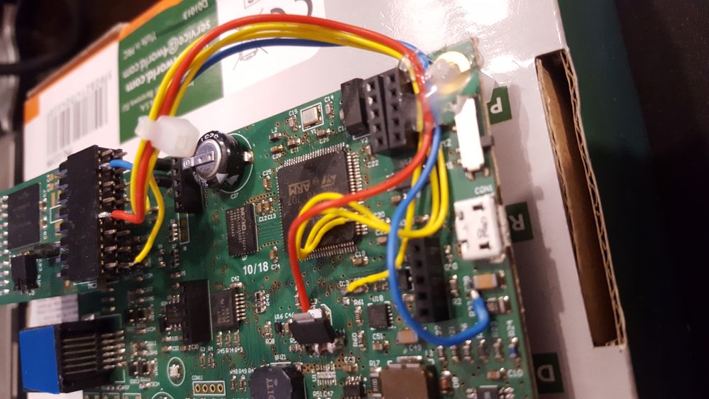

Hi Will,
You are right, my cables are really bad. But at this point, i need it to work at any speed and with any data signals. Also, I was able to use 4 data bits thanks to Clive's help on a Nucleo board. Just could not bring the rest 3 signals to my current PCB because the pins are already in use by other peripherals. I am also looking forward to the next pcb revision, with series resistors and 4 data lines.

they are very thick wires, do you have any wirewrap wire ?
too hard to retro fit... which eMMC chip are you using ?

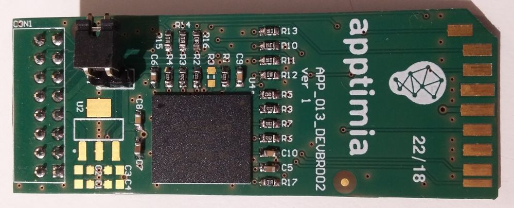

I can whip up a daughter board for you...
Attaching the test app for SD card on NUCLEO-L476RG, outputs diagnostic and menu on VCP at 115200 8N1
This was Lukasz's eMMC dongle for the NUCLEO-144 boards, also readable using a full size SD Card socket, which is what I was using today on the NUCLEO-64
