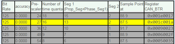

‎2017-09-08 7:08 AM
Hello Anand,
For CAN it is important not only to set proper baudrate, but also to set proper asmple point.
For purpose of translating MCU's clock and CAN baudrate into registers' values I often use this website:
https://community.st.com/external-link.jspa?url=http%3A%2F%2Fwww.bittiming.can-wiki.info%2F
Once you fill in the CAN controller name (ST BxCAN), clock rate (54MHz in your case) and sample point (87.5% by default), yu will get a table with popular CAN baudrates and registers configuration related to these baudrates. For 125kbit/s this is a result:
Please try these values (the one highlighted in yellow is a preferred one) and hopefully you will not get stuff error.
Regards
Szymon- Mark as New
‎2017-09-08 10:03 AM
Hello Szymon,
Thanks for the information that I need to consider sample point,
I have tried the values, which are mentioned by you. But still I am getting error.
BTR = 27, TS1 = 12, TS2 = 1.
Anything else i need to consider here.
