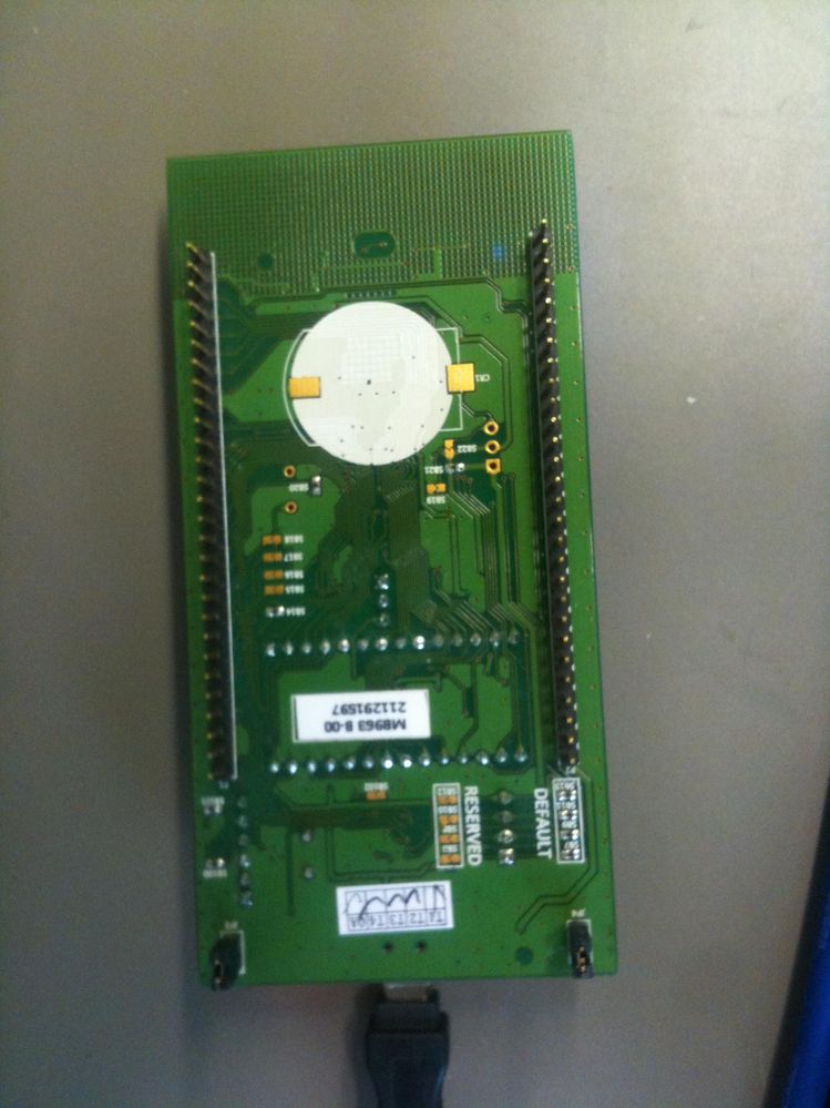

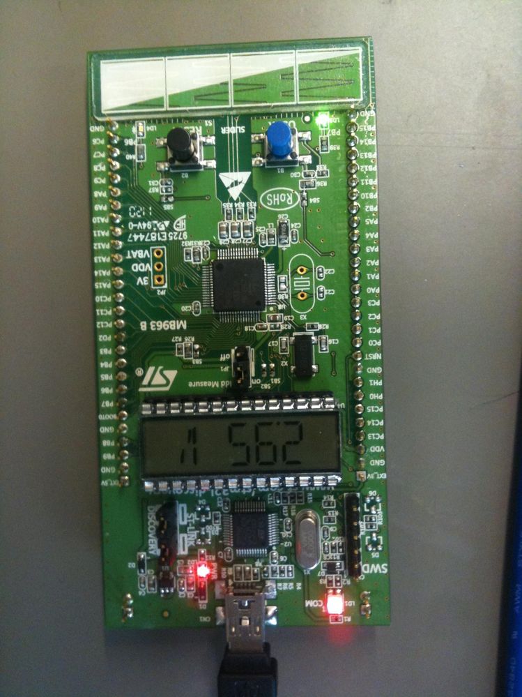

i have an STM32L-Discovery Board with 24 segment display. I wanted to flash a programm with Keil uVision V4.70.0.0 (STLink is set to SW, but no Cortex M device is found), with IAR Embedded Workbench V6.60.1.5104 and STM Studio V3.1.1. I always followed the instruction manual from st.com for setting up the project and for flashing it right. I also tried a few other options. But there was always a prompt, that the target could not be found. I installed the Driver Software from st.com without any success. I flashed the newest and older Firmwareversions and at the end there was a prompt, that it was installed successfully. The Controller works with the programm which was preinstalled. So, the Controller can not be out of work. I have no external debugger, but can only use the mini-USB-port. The Windows System indentifies the controller as ST-USB-Device (ST-Dongle). I had uninstalled the Windows-driver and installed the driver from Microelectronics. Without any changes. I have no clue, what to do.

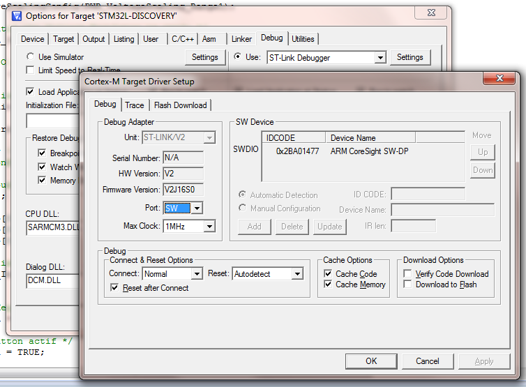

Posted on September 06, 2013 at 09:36
Hello Clive,
thank you for your answer. Aftersuccessfully flashing the new firmware I have the Version V2.JS0 (which seems to be not the newest one). But, when I want to Set the Debugger, it shows: No Cortex-M SW Device found (
/public/STe2ecommunities/mcu/Lists/STM32Discovery/Attachments/7439/Keil_STM32L_Problem.JPG
) . I plugged the device in and out, restarted the Keil application, without any changes. The Keil project is a blinky-project which was preinstalled. For a first test, I wanted to flash this programm.

Like you see in File ''
/public/STe2ecommunities/mcu/Lists/STM32Discovery/Attachments/7439/Bildschirm_2.JPG
'', the debugger is found by Windows. The driver seems to be OK, too (
/public/STe2ecommunities/mcu/Lists/STM32Discovery/Attachments/7439/TreiberVersion.JPG
). But I have no clue, why it isn't found by Keil or other programming software. Maybe, there is no connection between the debugger and the ARM-chip.

itfreak12
Posted on September 06, 2013 at 11:11
Thank you for your hint. I'm sorr, but I think, I didn't wrote it correctly. I am using the internal debugger, which communicates over mini-USB with the computer. I have no external debugger and don't want to buy one. So, my question was: Is there a failure on the board (for example, that the built in debugger can't communicate with the chip) or did I made a mistake while trying to connect the board to the computer?
That seems to be the case. Target is the STM32L1xx in your case. Coincidentially, the st-link hardware is also realized with a STM32. That could be confusing to beginners.
If you can see the target running, you can probably rule out a missing Idd-measurement jumper.
Alternatively, your application could have reconfigured the JTAG/SWD pins, or ignore the debugger in a sleep mode.
In this cases, you can get the target into the bootloader modus by pulling BOOT0 to H and BOOT1 to L, and reset it. Then, use the Flash Loader Demonstrator software from ST's site to erase the Flash.

Posted on September 06, 2013 at 15:21
You'd want to connect BOOT0 to VDD to get the device to reset into System Loader mode
If the device is not seen check also the CN3 jumpers are in place.
itfreak12
Posted on September 10, 2013 at 08:27
sorry, I didn't reply the last days. Thank you for your hints. I connected the BOOT0 to VDD. Then there was a sound like a click but nothing changed.
The CN3-Jumpers are both set.
Interesting is, that Keil shows me the firmware-Version of this board, but prompts, that there is no Cortex-M SW device is found (refer to the picture in my second post).

Posted on September 10, 2013 at 17:46
Well I have no magic solution. If you can't see the chip with the ST-Link Utilities, and you can't find a connectivity issue in the SWDIO/SWCLK paths, then I'd probably conclude the part has failed.
