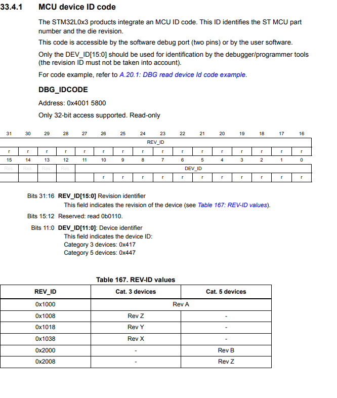

‎2018-10-23 5:58 AM
Read DEV_ID from DBGMCU, or see what ST-LINK Utilities or STM32 Programmer report.​
‎2018-10-23 6:02 AM
Thank you Clive.
Best Regards..
‎2018-10-23 6:06 AM
Hi @rcpcelikkaya​ ,
1- The revision code is marked on the device : Please refer to the datasheet on section "7 Package information", in "Device marking" paragraph.
https://www.st.com/resource/en/datasheet/stm32l073rz.pdf
2- You can read 'DBGMCU_IDCODE' register.
Bits 11:0 DEV_ID[11:0]: Device identifier
Have a look to the RM0367, in "33.4.1 MCU device ID code" section.
Kind Regards,
Imen
