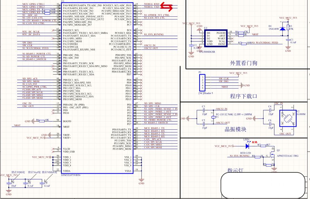

Can you share the schematic? Just wonder if theoretically this amount of current is possible through I/O

Posted on March 14, 2018 at 08:58
Posted on March 14, 2018 at 09:01
I would check capacitors. If you assumed that the board broken I would also disconnect xtal.
Divide & Conquer;)

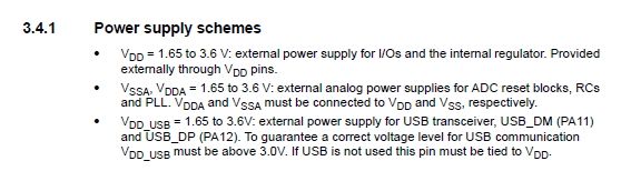

I would disconnect the USB if you suspect it...
