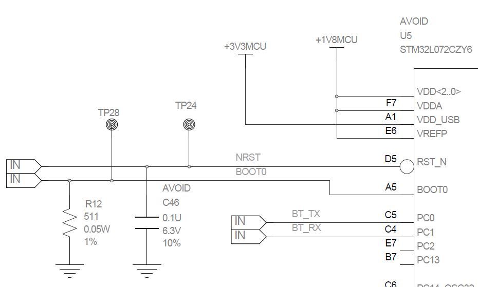

I am using STM32L072CBY6/STM32L072CZY6 in one of the designs and due to non availability of stock with reputed dealers, we got couple of sample batches from lesser known distributors. Strangely all the boards that we assembled using these stock turned out to be unprogrammable! When I try to connect my board to STLink v2 programmer, I get an error as below:
Can not connect to target!
         Please select "Connect Under Reset" mode from Target->Settings menu and try again.
         If you're trying to connect to a low frequency application , please select a lower SWD Frequency mode from Target->Settings menu.
I looked at the date code marked on the IC and I am not able to make out if they are genuine or fake. Can someone identify if these are genuine ICs? Any help is appreciated, Thanks

I am using ST-Link V2 and I do have NRST line connected to the programmer. Strangely I notice that the the NRST signal is always held low and I couldnt locate any short circuit on board! The NRST pin shows ~300k ohm impedance w.r.t ground goes low as soon as I power up the board. I see it happening in all 20 boards that we assembled!
NRST low, perhaps an orientation/pin-one type thing? Also the absence of VDDA/VSSA, which power the POR and PLL circuits
I checked the orientation and seems ok. XRAY image of the IC after soldering looks okay (top view) but I am not able to reliably confirm if VDDA/VSSA are soldered properly.
Is there any tool (SW/HW) using which I can communicate with the device via UART by pulling BOOT0 high?
I am attaching a portion of my circuit for reference. With this configuration I always see NRST is held low. I tuned the +1V8MCU power supply to 2.2V and still NRST was low. I connected +3V3MCU rail to VDD, VDDA and VREFP and surprisingly NRST got pulled high (3.3V). I got excited and tried programming the board but still the result was same. I put back the VDD, VDDA and VREFP to 1.8V and NRST was back to low state. I can see the controller is doing something internally but not able to figure out what!
I checked C46 and the value was 106nF, so I guess thats good. I tried removing C46 altogether and it didnt do anything.

The core would need to be running, which won't be occurring if NRST is clamped low.
The protocol is described in AN3155, as I recall. Want to connect at 9600 8E1 (Even Parity), sending an 0x7F pattern, looking for an 0x79 response.
