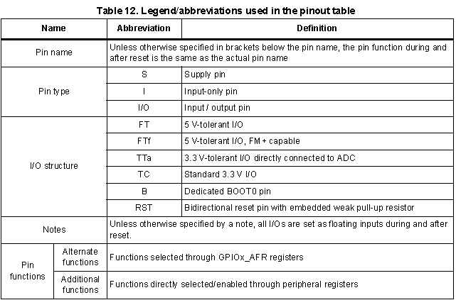

    A different part's (STM32F302xB) datasheet legend table has TTa indicating 3.3 V tolerant I/O directly connected to an ADC

    You should probably update your datasheet.
    http://www.st.com/content/ccc/resource/technical/document/datasheet/cd/46/43/83/22/d3/40/c8/DM00090510.pdf/files/DM00090510.pdf/jcr:content/translations/en.DM00090510.pdf
    Rev5 explains about TTa IO type in table 12:0690X00000605sNQAQ.png

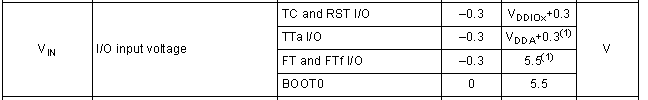

    It also specify Absolute Maximum Ratings for this type of GPIO in table 21:
    as well as General operating conditions in table 24:
    You will also find a lot of data in the I/O port characteristics ...

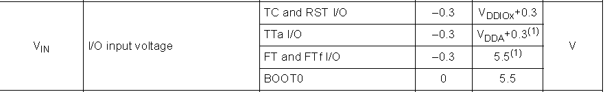

    On TC pins, there are clamping diodes to VSS and VDD.
    On TTa pins, the upper clamping diode goes to VDDA due to the analog feature of the pin.
    On STM32L0 devices, VDDA must be connected to VDD, therefore TC and TTa are electrically equivalent from a specification point of view.
    Merging the two type allows to simplify the datasheet.
    Everybody likes simpler specification!
    On STM32F0 devices, VDD and VDDA voltage could be different therefore TTa pins require a dedicated description. like that:
    for example.(from STM32F072x8 datasheet)
