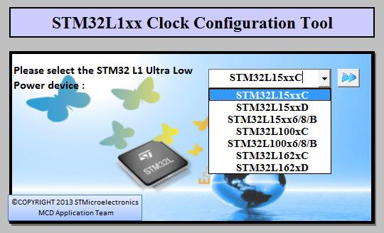

I am trying to configure the clock source in a STM32L Nucleo Board (that mounts the STM32L152RE microcontroller). I use EmBitz as IDE.
I have downloaded the Excel file STM32L1xx Clock configuration tool from ST that generates the system_stm32l1xx.c file to configure the microcontroller.
However the configuration tool does not allow to select the microcontroller I use (STM32L15xxE is not present).
Any idea how to create the configuration file?

    This configuration is valid for all STM32L1 family.
    marcogrossi89
    January 11, 2016
    Posted on January 11, 2016 at 14:50
    Yes, but when you start the tool (see the image below) you are asked to choose the microcontroller and there is not STM32L15xxE option.

    Use C optioc. E option is only different flash size. RCC peripheral is the same. Generate file will be valid.
