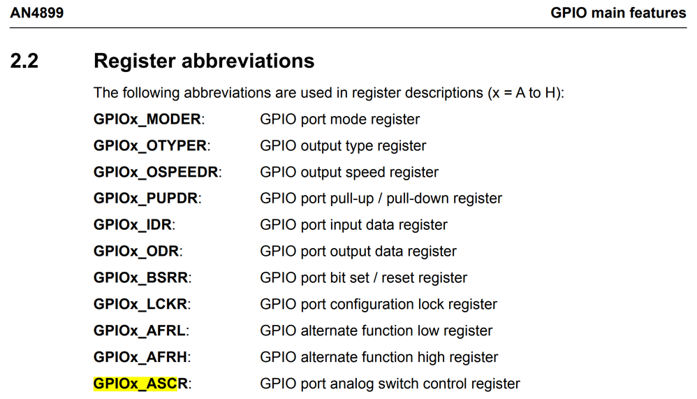

Hi @F.Belaid​ ,
I read the AN4899 (rev3 mar 2022), and it mentions the register GPIOx_ASCR in multiple places.
What is this register? I cant found it in RM of F1, F4, G4, H7.
It is not mentioned in the section 2.2 Register abbreviations.
FBL
Hello @Nikita91​,
First, GPIOx_ASCR register is specific to some series. For example, you can find it in L4 Reference Manual section 8.5.12. This register is used to configure the analog connection of the IOs to the ADC input.
Second, AN4899 note is applicable to all ST MCUs.
Best regards,
FBL
