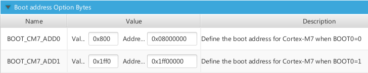

0693W000006FejoQAC.pngAlso, reading the Option Bytes with STM32CubeProgrammer I get these values:
0693W000006FelVQAS.pngSo I think that it is correct to put my code at 0x08000000. About the GPIO clock enable, I am enabling it with the "RCC_AHB1ENR |= 1". When I switch on the board with BOOT0 pin at 3.3v y can connect the booloader with DFU using STM32CubeProgrammer but when I switch on the board with BOOT0 pin to 0v nothing occurs.

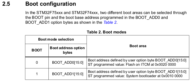

I am also a bit confused because, in the reference manual of STM32H750 y get this:
0693W000006FetKQAS.pngSo I don't know why my chip have these options bytes (may be a second hand chip), but the fact is that the value I read of BOOT_ADD1 using STM32CubeProgrammer is 0x1FF00000 and that is a reserved area! :| and the other fact is that that BOOT_ADD1 runs ok because I am connectin using STM32CubeProgrammer using DFU!
You want to place your image at 0x08000000, the first things there are NOT CODE, but vectors (addresses to something else..)
ie
.word 0x20002000 // Some RAM for Stack
.word 0x08000009 // First Instruction, THUMB
// 0x08000008
// RCC_AHB1ENR |= 1;
          ldr    r3, =0x40023830
          ldr    r2, [r3, #0]
      orr.w  r2, r2, #1
         str    r3, [r3, #0]
The H750 is not an F750 or F740 device
