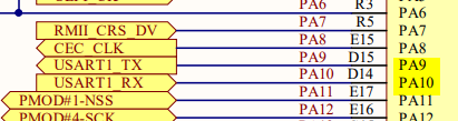

> it leads me to believe that I should be able to write to USART1 and have it show up on the virtual com port in windows.
This is correct.
> I've tried:
You only need to configure the USART and use HAL_UART_Transmit. The UART to USB bridge is taken care of by the ST-Link chip.
> I have my logic analyzer tapped into pins PB14/PB15
Looks like the VCP on the board is on PA9/PA10.
Najati
Ah! Of course! Don't know why I assumed that USART1 only had one option for output pins :downcast_face_with_sweat:
Thanks for the quick response - that solved it! =)
