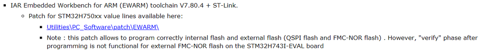

  • Just for your information, if you want to use an older version of EWARM IDE, you have to apply the patch provided under STM32H7Cube package under the path below:
Repository\STM32Cube_FW_H7_V1.3.0\Utilities\PC_Software\patch\EWARM
This was mentioned in the release note:
